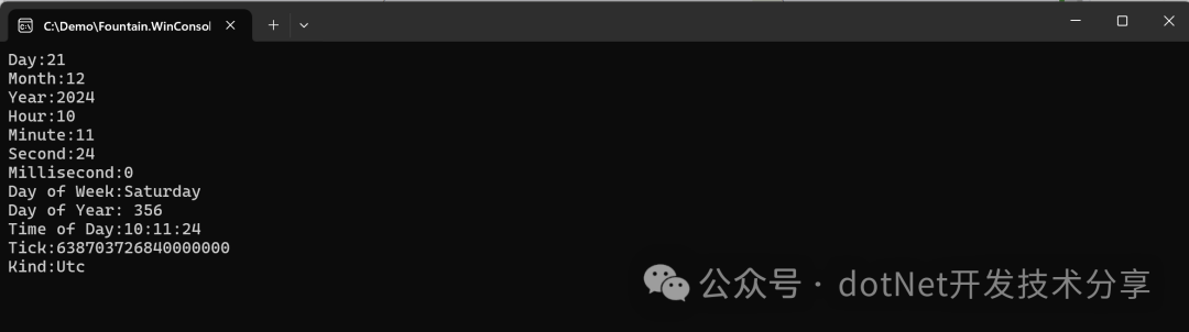

2、创建 DateTime
下面通过示例,了解如何创建DateTime对象。
namespace Fountain.WinConsole.DateTimeDemo{    internal class Program    {        static void Main(string[] args)        {            DateTime preDateTime = new DateTime(20241221101124,DateTimeKind.Utc);            Console.WriteLine("Day:{0}", preDateTime.Day);            Console.WriteLine("Month:{0}", preDateTime.Month);            Console.WriteLine("Year:{0}", preDateTime.Year);            Console.WriteLine("Hour:{0}", preDateTime.Hour);            Console.WriteLine("Minute:{0}", preDateTime.Minute);            Console.WriteLine("Second:{0}", preDateTime.Second);            Console.WriteLine("Millisecond:{0}", preDateTime.Millisecond);            Console.WriteLine("Day of Week:{0}", preDateTime.DayOfWeek);            Console.WriteLine("Day of Year: {0}", preDateTime.DayOfYear);            Console.WriteLine("Time of Day:{0}", preDateTime.TimeOfDay);            Console.WriteLine("Tick:{0}", preDateTime.Ticks);            Console.WriteLine("Kind:{0}", preDateTime.Kind);            Console.Read();        }    }}

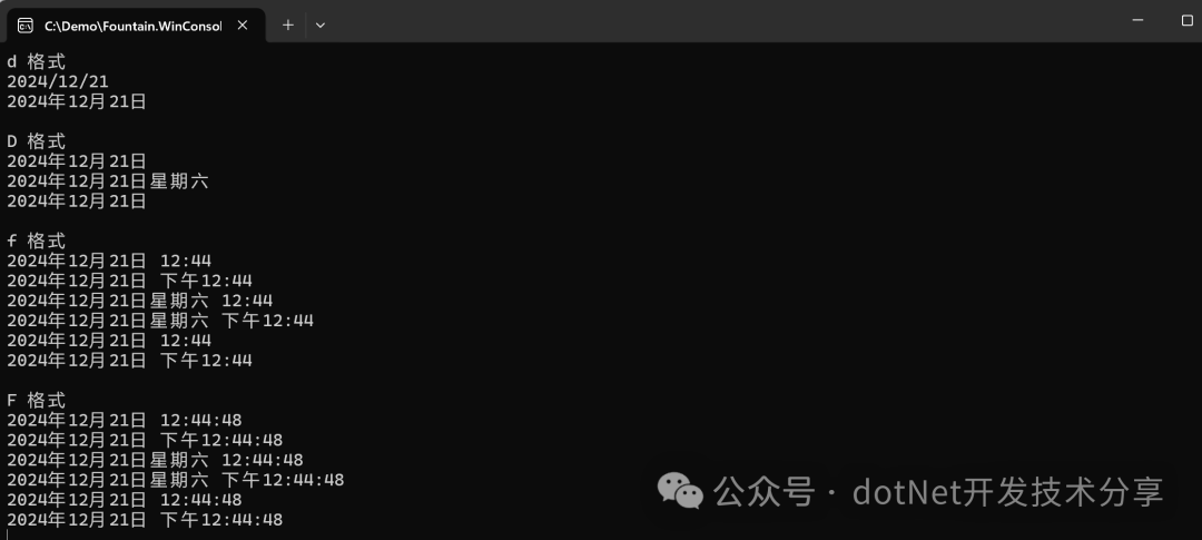

5、日期时间格式化
DateTime 的格式化是将其转化为多种格式的字符串,而GetDateTimeFormats方法可返回计算机当前区域性的所有可能的 DateTime 格式。除了GetDateTimeFormats,还可以使用ToString方法来格式化。下面代码段了解其使用。
DateTime dateTime = DateTime.Now;// 日期时间格式: d, D, f, F, g, G, m, o, r, s, t, T, u, U,Console.WriteLine("d 格式");string[] dateFormats = dateTime.GetDateTimeFormats('d');foreach (string format in dateFormats){    Console.WriteLine(format);}Console.WriteLine("D 格式");dateFormats = dateTime.GetDateTimeFormats('D');foreach (string format in dateFormats){    Console.WriteLine(format);}Console.WriteLine("f 格式");dateFormats = dateTime.GetDateTimeFormats('f');foreach (string format in dateFormats)    Console.WriteLine(format);}Console.WriteLine("F 格式");dateFormats = dateTime.GetDateTimeFormats('F');foreach (string format in dateFormats){    Console.WriteLine(format);}

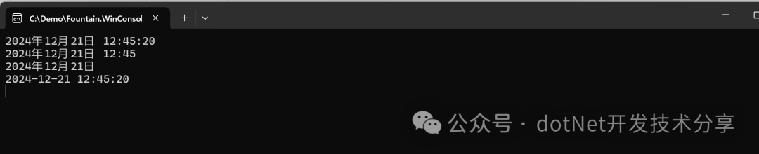

// 20241221日 12:41:33Console.WriteLine(dateTime.ToString("F"));// 20241221日 12:42Console.WriteLine(dateTime.ToString("f"));// 20241221Console.WriteLine(dateTime.ToString("D"));// 2024-12-21 12:44:05Console.WriteLine(dateTime.ToString("yyyy-MM-dd HH:mm:ss"));
