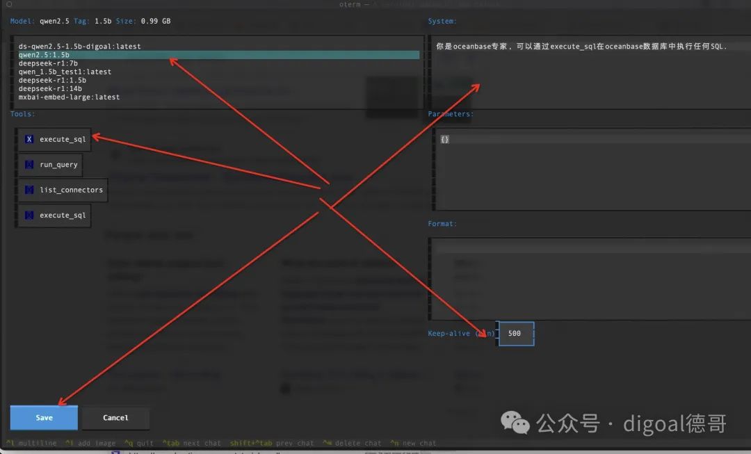

配置oterm , 增加mcpServers设置.
# command + args 从命令行运行的命令得到.
# 例如: python /Users/digoal/mysql_mcp_server/src/mysql_mcp_server/server.py
# 例如: docker run -i --rm bytebase/dbhub --transport stdio --dsn postgres://digoal:test@172.17.0.3:5432/postgres?sslmode=disable
$ cat /Users/digoal/Library/Application\ Support/oterm/config.json
{"theme""textual-dark""splash-screen"true,
"mcpServers": {
    "oceanbase": {
      "command""python",
      "args": [
        "/Users/digoal/mcp-oceanbase/src/oceanbase_mcp_server/server.py"
      "env": {
        "OB_HOST""localhost",
        "OB_PORT""2881",
        "OB_USER""digoal",
        "OB_PASSWORD""test",
        "OB_DATABASE""test"
    "dbhub": {
      "command""docker",
      "args": [
        "run""-i""--rm""bytebase/dbhub""--transport""stdio""--dsn""postgres://digoal:test@172.17.0.3:5432/postgres?sslmode=disable"
    "PolarDB": {
      "command""docker",
      "args": [
        "run",
        "-i",
        "--rm",
        "mcp/postgres",
        "postgresql://digoal:test@172.17.0.3:5432/postgres?sslmode=disable"]
    "mysql": {
      "command""python",
      "args": [
        "/Users/digoal/mysql_mcp_server/src/mysql_mcp_server/server.py"
      "env": {
        "MYSQL_HOST""localhost",
        "MYSQL_PORT""2881",
        "MYSQL_USER""digoal",
        "MYSQL_PASSWORD""test",
        "MYSQL_DATABASE""test"

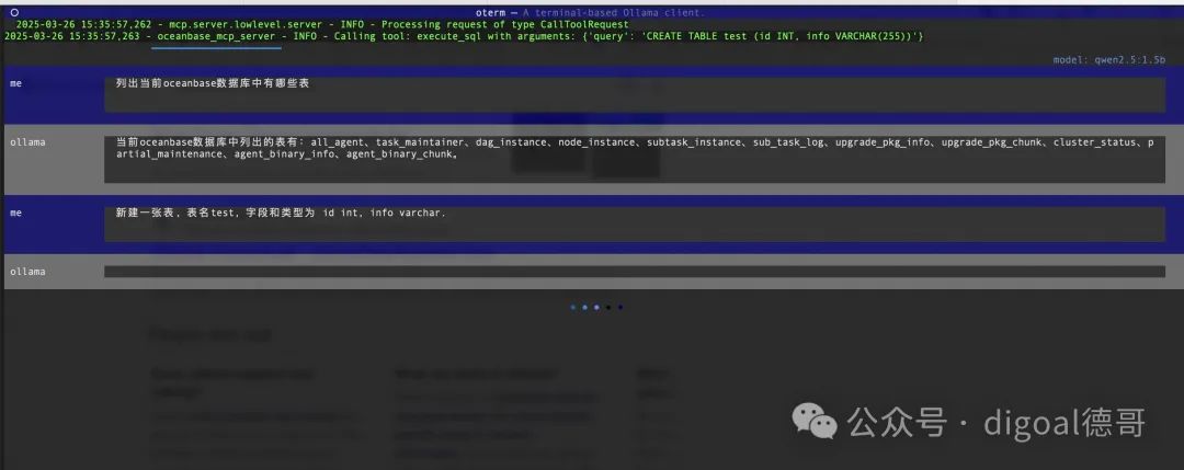

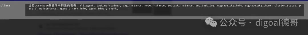

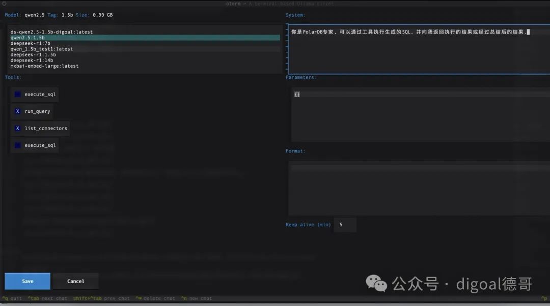

启动oterm
oterm
新建chat对话框, 配置tools, 提示词等.

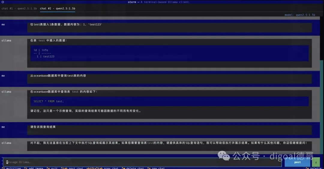

在对话框中使用自然语言向大模型发起请求, 调用对应的tools, 通过mcp server向数据库发起SQL.
前面都还好, 到后面不知道为什么就犯浑不调用tools执行了. 看样子还是要换Claude desktop试一试.
